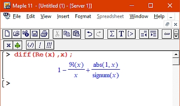

This is what a slightly newer version of maple thinks about the derivative of the real part of a complex
I assume that neither SMath nor its version of maple can get that, and if they could, handling it numerically might be tricky.
Three possible methods to solve it are attached.
