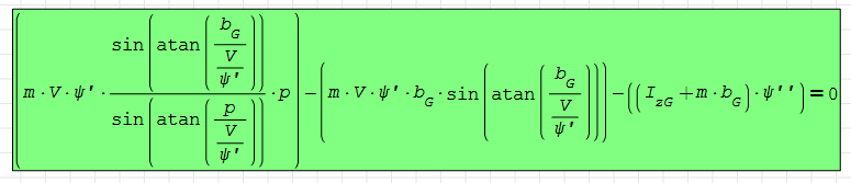

I solved this differential equation:
I wanted to know if the procedure I used is correct…
this is the .sm file… vel-imb.sm (25.61 KiB) downloaded 1038 time(s).
Thanks in advance
#2 Posted: 1/14/2020 4:50:33 PM
Maybe it is correct. The solver you use is transmitted Unicode ?
not digestible as is. Why not stay Native Smath ODE Solver(s) ?
... as doctored/attached SS 6179
vel-imb Doctored Native Smath ODE solver(s).sm (26.39 KiB) downloaded 1137 time(s).
