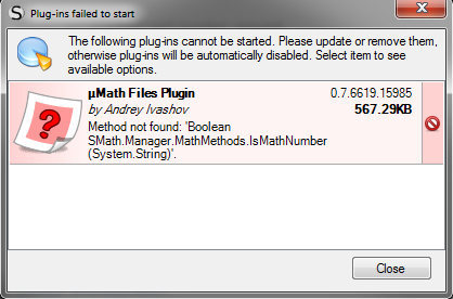

uMath Files Plugin appears to be broken with new release.
#3 Posted: 3/13/2018 2:58:12 PM
2,344 likes in 4,057 posts.
Thank you! Fixed and new plug-in version uploaded.

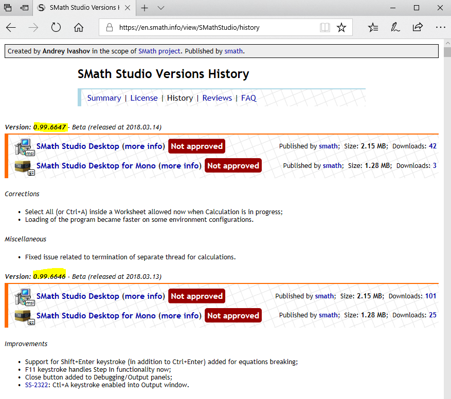

The following SMath Studio nightly builds are marked as NOT APPROVED and will not be suggested to download to anyone anymore: 0.99.6646, 0.99.6647!
