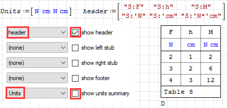

#3 Posted: 10/20/2023 4:29:10 PM
It is at least possible to put other regions into text regions. So in general, this might not be impossible. Yet, for now, it doesn't even seem to be possible to put more placeholder into custom regions. An important application would be Mathcad-like plots, where you have placeholders for the x and y values and for the axes limits.
For now I recommend to make use of tables with string-encoded SMath expressions. Whatever you can write or display in a formula region can be displayed in a table cell (with minor deviations like italic/roman style).
