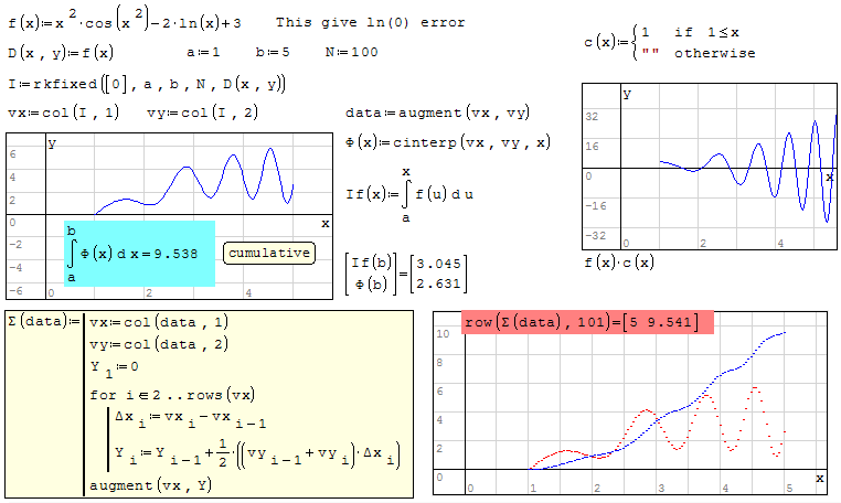

Hi. I can't reproduce this in SMath.

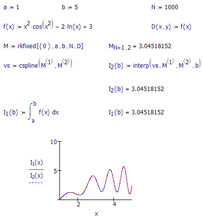

#2 Posted: 11/29/2018 11:48:00 PM
1/1 in Smath 6179, proof: the snippet.
Cheers Alvaro
Integrate with ode solver.sm (29.07 KiB) downloaded 1329 time(s).

You may not be able to implement the Mathcad bloc Given/ODEsolve.
Hi Jean. Actually not, just the solver, without the given.
I found how to call the odesolver, with D(x,y)=[f(x)].
This method is much more faster than the direct integration.
But remains the ln(0) error, which seems to be a bug in the odesolvers, because zero isn't in the domain range.
Integrate with ode solver.sm (10.17 KiB) downloaded 1274 time(s).

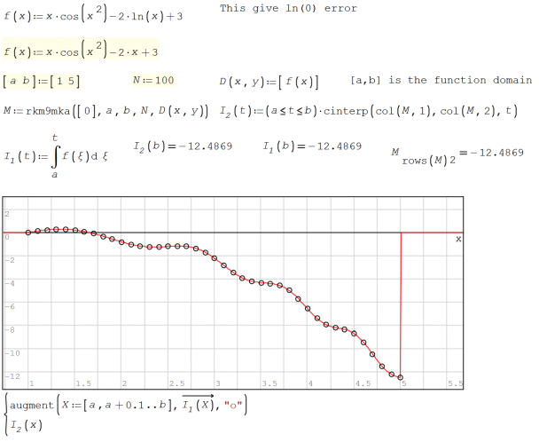

#8 Posted: 11/30/2018 12:29:42 PM
Buenos dias Alvaro !
ln(0) was introduced in Mathcad 11 soon after release via update [from recollection]
There is more in the attached, specially wrt parametric D(,,,).
ODE 0_Model General.sm (29.47 KiB) downloaded 1310 time(s).

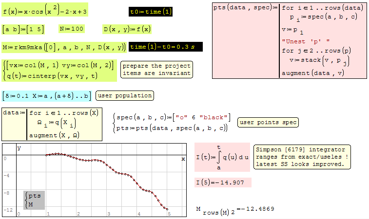

#9 Posted: 11/30/2018 12:34:54 PM
#10 Posted: 11/30/2018 3:36:38 PM
... refreshed version wrt explore all solvers.
ODE 0_Model General.sm (38.44 KiB) downloaded 1265 time(s).
Alvaro 11/30/2018 3:54:00 PM, frapuano 11/30/2018 5:58:00 PM, Davide Carpi 12/3/2018 9:18:00 PM
