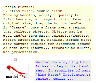

Don't need a plugin, use the Insert => Picture => Create.
It plugs a box with handles ... stretche each direction.
To view the bounding box: click on the square in the menu,
slide over your collected stuff: text, image, equations ...
Click anywhere in that creation, the inside stuff disappears,
stretche with the handles, click away outside, bingo the
all creation is back.

next some source image/reference, next your functions/equations/parameters/graphs ...
Your can finally frame a printable Smath page. What other gyzma can do more professional ?
Just different than Mathcad 11 but surely as presentable !

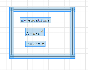

![2016-03-24 20_20_57-SMath Studio Desktop - [Page1_].png](/en-US/files/Download/F5C4Dp/2016-03-24-20_20_57-SMath-Studio-Desktop---[Page1_].png)
It seems that objects earlier in execution pipe (upper on the sheet) are selected first, but displayed on the background. Therefore if there exist overlapping objects, I cannot select the object which I see in the front.
The figure explains. If the boxes are arranged like in the picture and if I click with mouse the area marked with arrow, I select green box, which appears to be on the background. Why?
Wouldn't it be logical with other way round? Other way round would allow to create also bounding boxes with ease.

It would be more logical when clicking things you see, they get activated.
For example, the equations in the yellow box are behind the box. One can see them, which is nice feature, but one cannot edit them (unless you drag the yellow box away).
It would be very handy and easy to play with bounding boxes if the equations "in" the box would be on top both visually, and also for selecting with mouse.
I don't know the design intent. Just want to mention that you don't need to drag away the background box. Exploit the fact that you can move the region focus using the keyboard. Just click one region and press TAB or Shift TAB or Arrow up and down. A region with focus is in the foreground and you can move it with the mouse (drag the border) or edit it's contents.
This is usually more convenient than to temporarily remove the covering region.
Thanks! The TAB trick is handy. I did not knew this (or forgot about it). It helps. However, it would be even easier it the focus would go automatically to the object displayed in the front. The focus order could follow the reverse execution order, it would be also logical.
