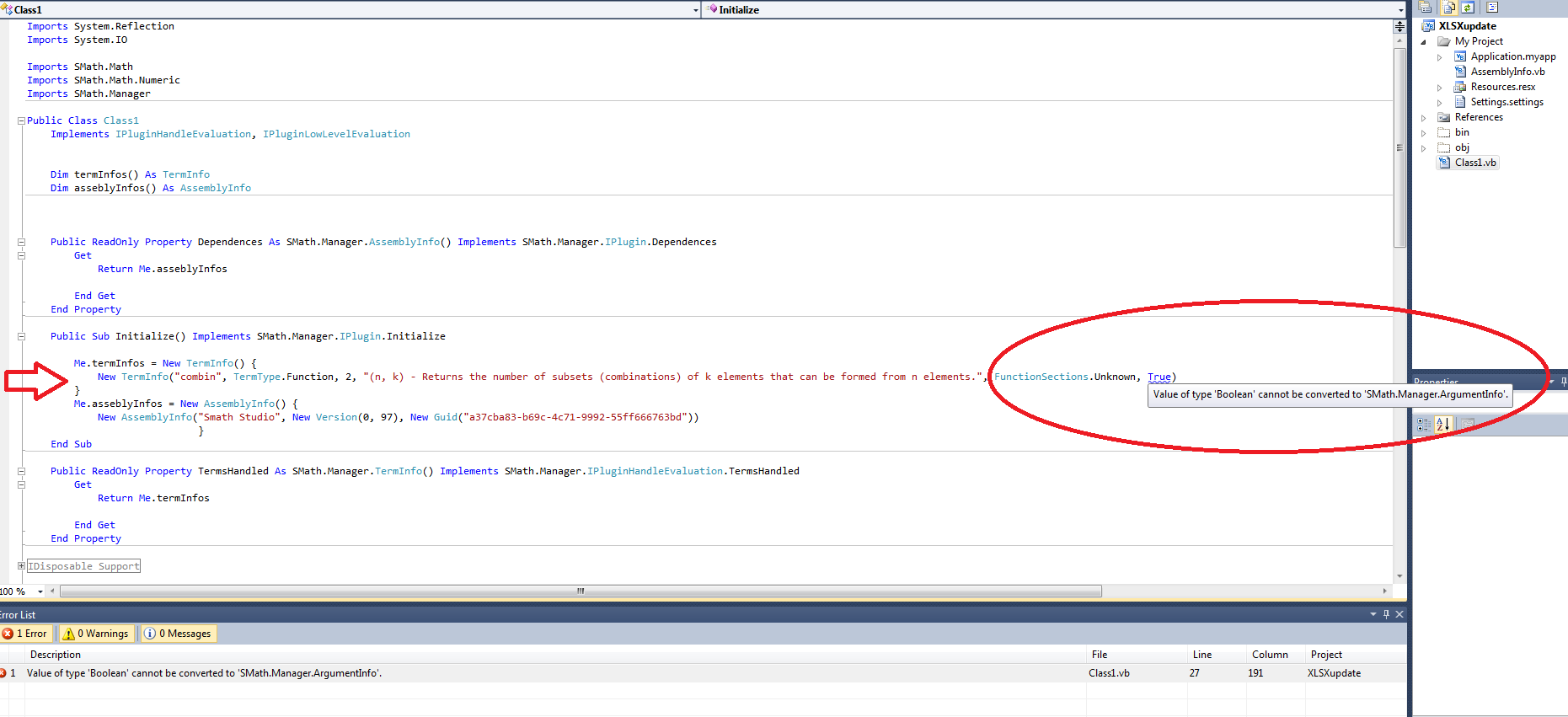

Good day,
I am attempting to follow through tutorial on plugin development in VB.NET:
https://smath.com/wiki/GetFile.aspx?File=Developer%20Guide/Tutorial%20on%20creating%20plugin%20for%20Smath.pdf
I have not reached a glorious conclusion yet, however even now I can notice something to be incorrect (see screenshot).
Could someone please point out what I am doing wrong? Please keep in mind that I have never attempted to piece few lines of code together before and hence might miss obvious things. I am attaching my project folder.
Thanks!

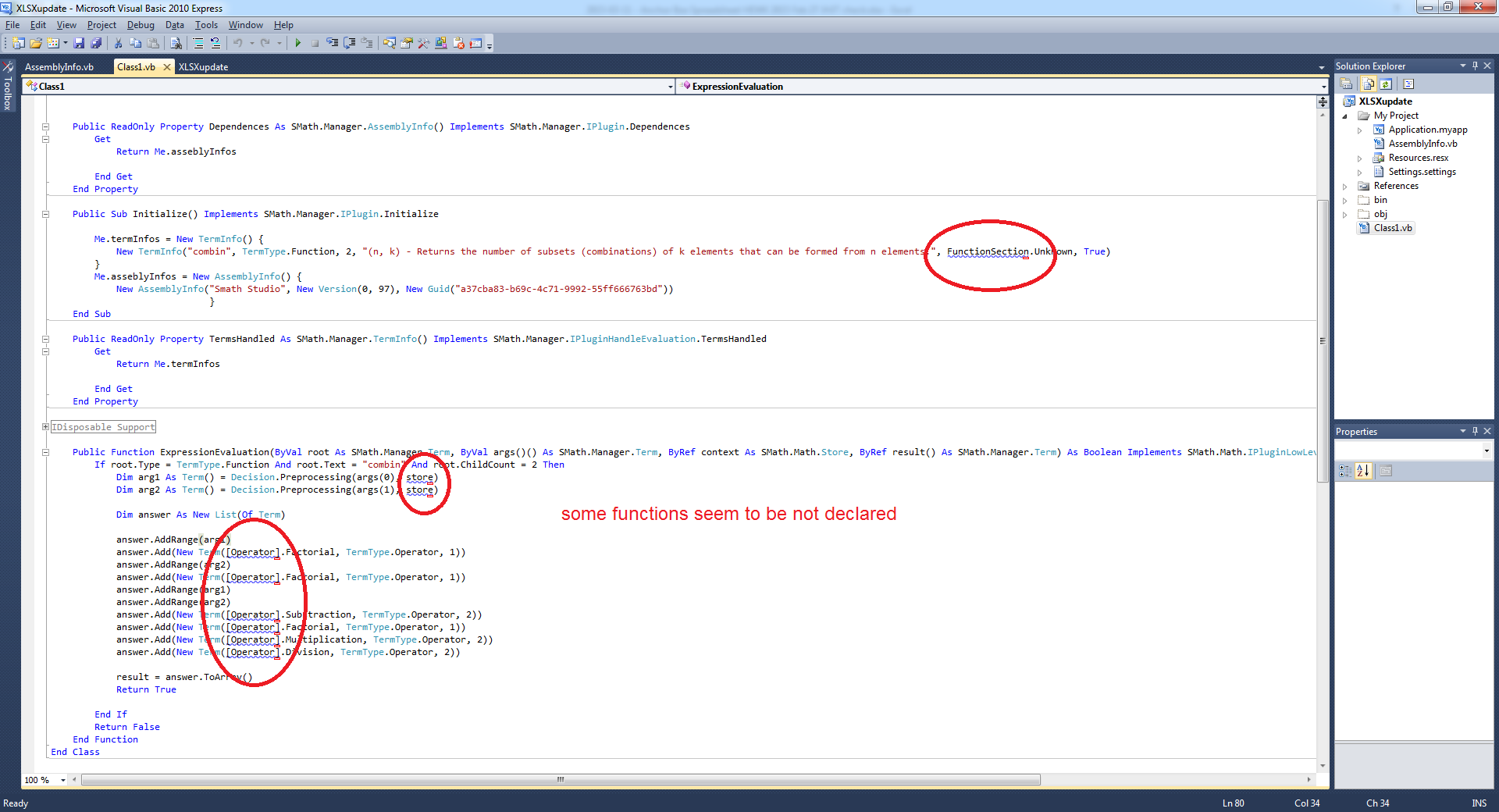

The function argument is ByRef context As SMath.Math.Store -> change it into ByRef store As SMath.Math.Store (or change the store variables into context)
use Operators instead of Operator

Also, back to plugin tutorial..Now how about this one:
Thank you!!

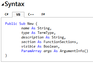

#4 Posted: 3/16/2015 2:31:01 PM
You have to delete the third argument (old syntax, I guess)
