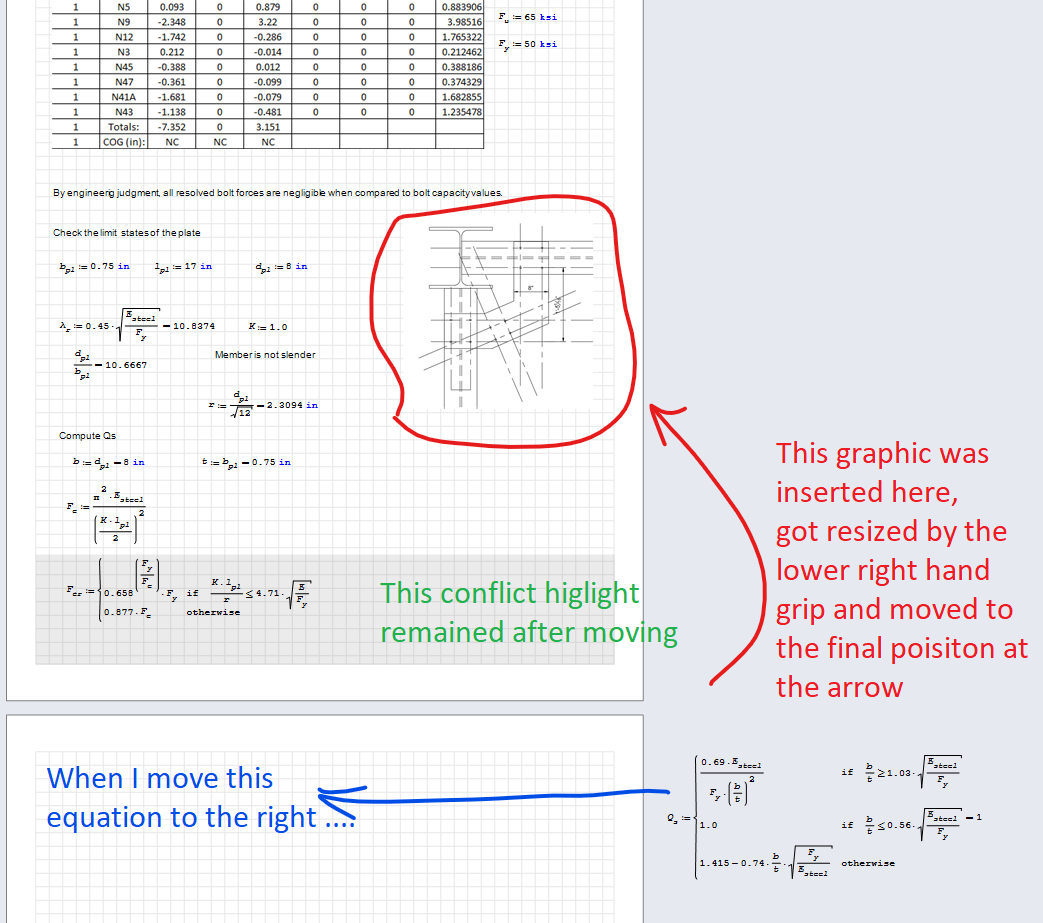

I am not sure how to describe exactly, but when I try to paste images into the scratch area on the right, SMAth starts to auto paginate and prevents me from manually move the graphic over.
Here is a screenshot.
screenshot
I do not remember this behavior. I am used to piling up screen snips and the like on the right as references as I work.

The reason is in your third image (according to what I see on the screenshot).
The rule is: your regions should always be located in the vertical bounds of the page, even if it is a scratch area.
Because of the size of your 3-rd image SMath Studio cannot display it in the vertical page bounds (space of the first page just not enough for this). That is why SMath Studio automatically reduces available size of the first page (notice a gray area) to put this 3-rd image (and all content with larger y-coordinate) to the next page.
Solution for you is to make the image smaller.

I am not sure if this is the same issue, but when I try to resolve a bounds conflict, the highlight region is still in effect and then SMATH moves things in a way that I do not understand. It clashes with things on the previous page.
Any ideas?

It is really hard to understand what is going on here, but I would suggest you to select a region you are talking about and try to move it up/down using keyboard arrow keys. This will help you to understand the logic under the hood.
Please note: we are still have a positioning issue when moving regions with a mouse in Page mode (if you will move a region by mouse from one page to another), so something it is easier to use keyboard.
