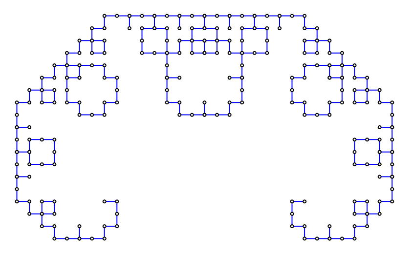

Can we create this in SMath.
I had a Mathcad-sheet but cannot find.

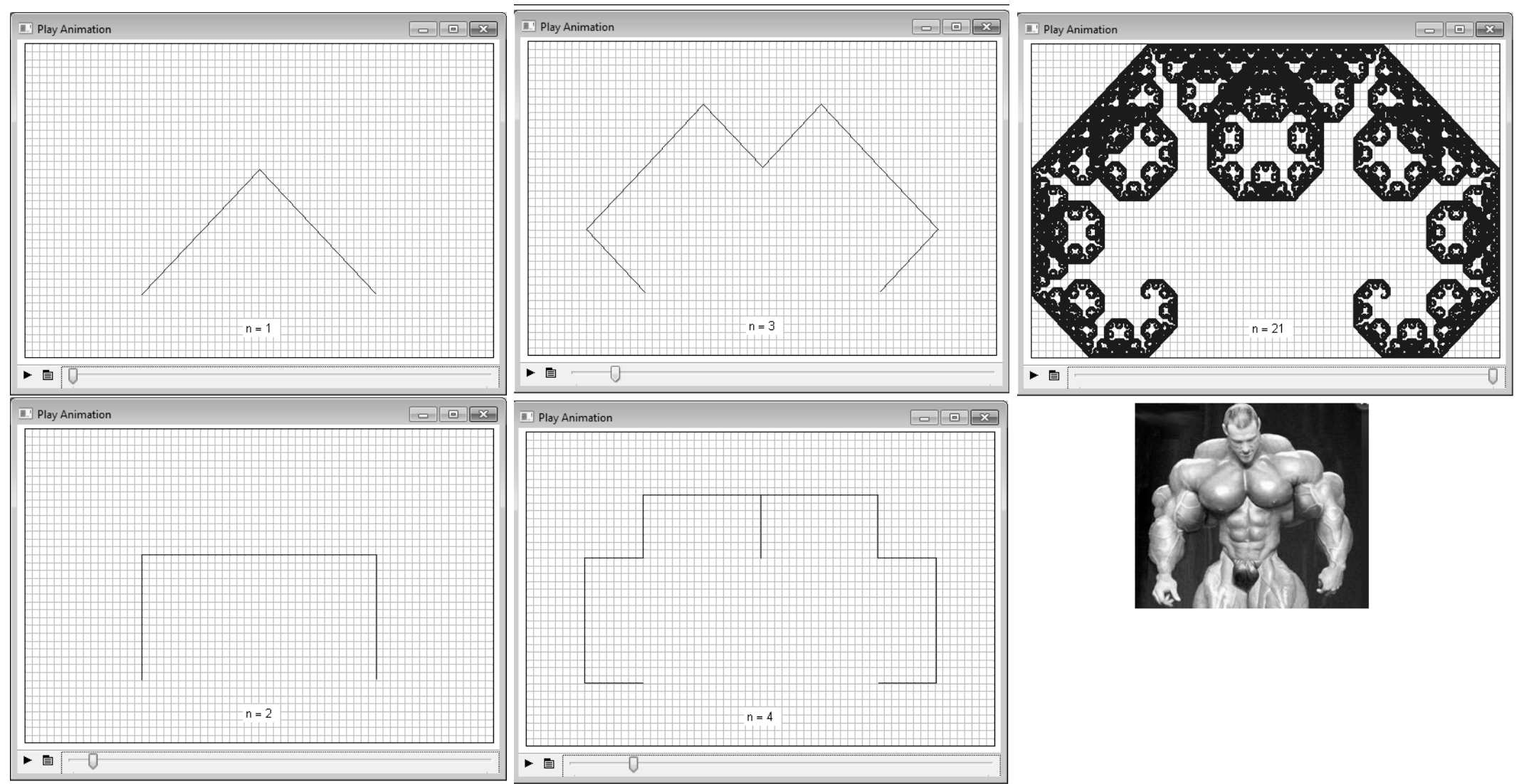

Я просил анимацию фрактала Леви.
А вы мне высыпали все, что у вас есть!

I found this video that might help...

http://twt.mpei.ac.ru/MCS/Worksheets/Levy-curve.xmcd

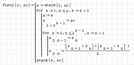

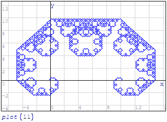

#9 Posted: 10/30/2023 3:32:18 AM
598 likes in 1,380 posts.
Here is the smath file for that mathcad example.
fractal_levy.sm (9.99 KiB) downloaded 1260 time(s).

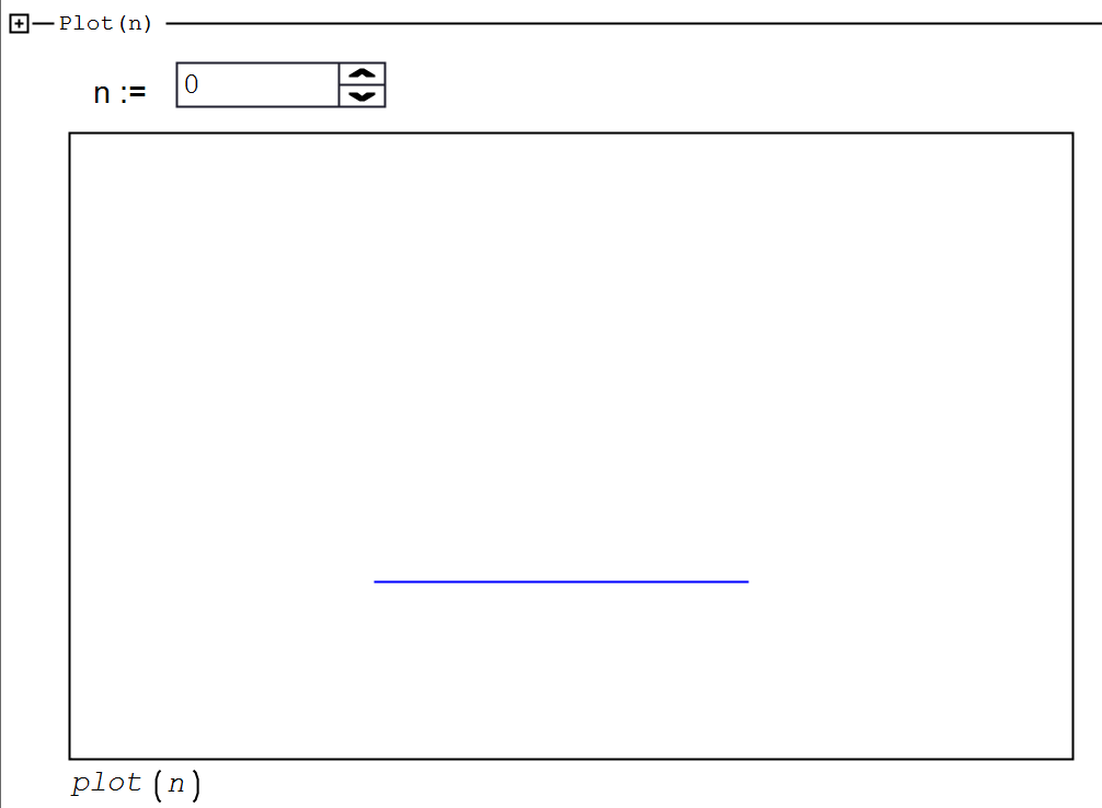

With n=0
Levy-Fractal.sm (12.3 KiB) downloaded 1259 time(s).
Did you seen Levi fractals by n<0 or n not integer?

Here is your file with animation added...
Levy-Fractal_animated.sm (24.31 KiB) downloaded 1281 time(s).
