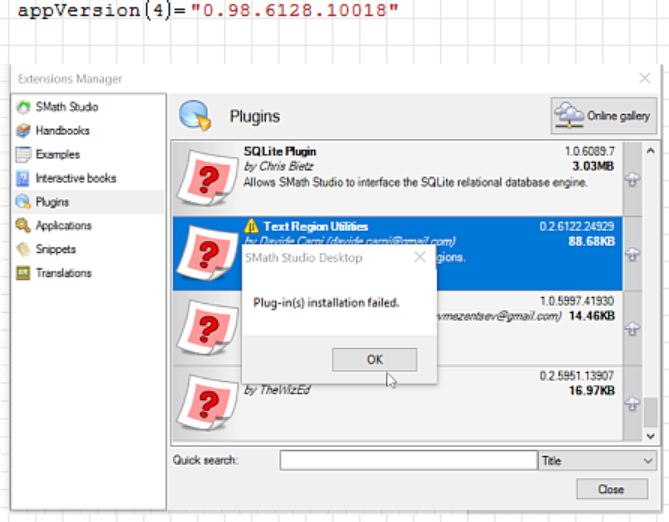

Unable to install Text Region Utilities plugin in 98.6128

#2 Posted: 10/12/2016 10:35:31 AM
1,442 likes in 2,935 posts.
thank you, I'll fix it ASAP
#3 Posted: 10/12/2016 11:39:21 AM
2,335 likes in 4,034 posts.
Davide, I've already fixed it by simple plug-in rebuild. Sorry, had no chance to inform you.
New version of the plug-in can be installed with no issues.

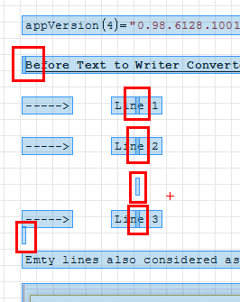

The "insert a toolbox" in Text Region Utilities Plug-in exibit erratic behaviour.
1. It shifts the selected text to a new position.
2. Apparantly, the empty lines between text lines are also considered as text?
3. Had to press "Apply" more than once to convert all selected text.
I'm not able to reproduce it; if you save the document with text regions and you load it again it still happens? If yes can you attach it here?

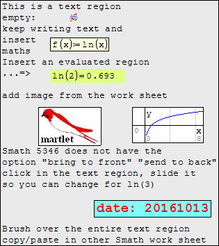

#7 Posted: 10/13/2016 10:24:20 AM
I don't understand what a "Tool Box" could be ?
Smath 5346 "Text Box" allows lot of decoration.
Decoration for a Web page presentation for instance.
As an Engineering working document: decoration is
too much, IMHO.
Each Shift/Enter adds blank line(s), an empty space
where to slide: images, graphs, foreign text ...

The original file is attached; the problem still exists even after saving and re-opening.
Before Text Converter.sm (73.44 KiB) downloaded 1110 time(s).

#9 Posted: 10/13/2016 11:23:02 AM
Thank you, is exactly what I was thinking. If you select all (CTRL+A) you can see some empty text region, probably created with an UNDO action (because my bad coding in the converter feature). Should be no more an issue with the coming plugin update (but if existing you have to remove them manually).
I don't understand what a "Tool Box" could be?
Just a region that wraps some generic utilities related to the worksheet; when it will be possible I plan to move them in a toolbar (I'm working on it).

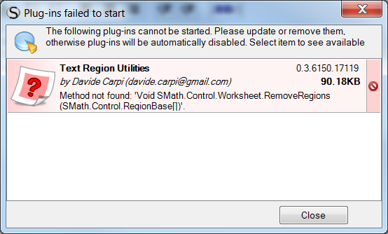

Plugin does not seem to work in latest SS 6179
#13 Posted: 12/15/2016 3:22:31 PM
Thank you Alex,
recompiled, try now.
sergio 12/16/2016 3:41:00 PM

Alexander O. Melnik
Alexander O. Melnik
127 likes in 498 posts.
works fine now, thanks!
