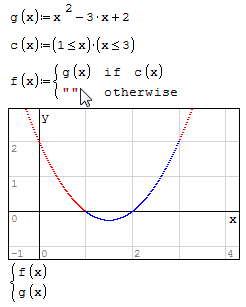

Hi, is it possible to set up interval for the function, which i want to figure in X-Y plot? For example with using if-else or something different. I need to figure only some interval but when i zoom in or zoom out the SMath will stop working.

Yes, it is possible. You can find in the forum different examples like the one I attach to you but also with other modes like if-else.
[albumimg]1456[/albumimg]
#3 Posted: 6/23/2017 9:06:23 PM
Observe the blanking character "
