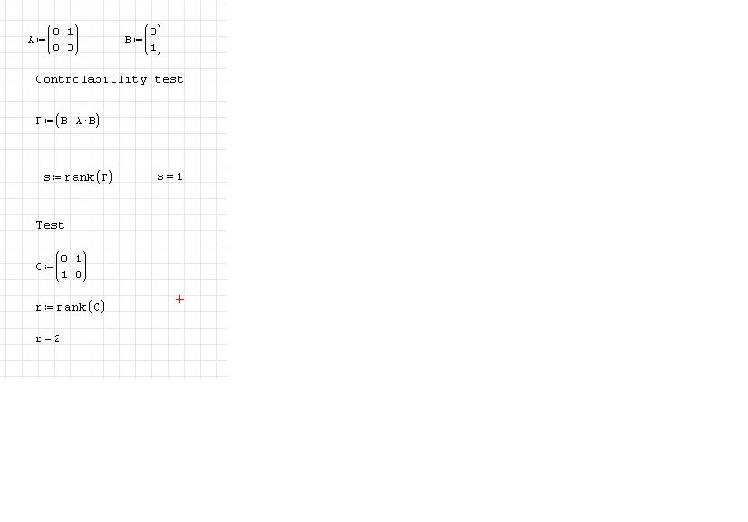

I'm using SMATH for a controls class that I am taking. I am getting bad values for rank of a matrix.
A=[0,1;1,0]
should return a rank of 2
I keep getting a 1
A=[0,1;1,0]
I keep getting a 1

You have made an error defining Γ
You need to use the augment() function; without this function you create a nested matrix.
BTW there is a bug because calling directly the rank function when the first matrix element is a nested matrix, a type conversion error appears.
regards,
w3b5urf3r
rank.sm (11.12 KiB) downloaded 1214 time(s).
regards,
w3b5urf3r

Excellent, thanks to both of you.
