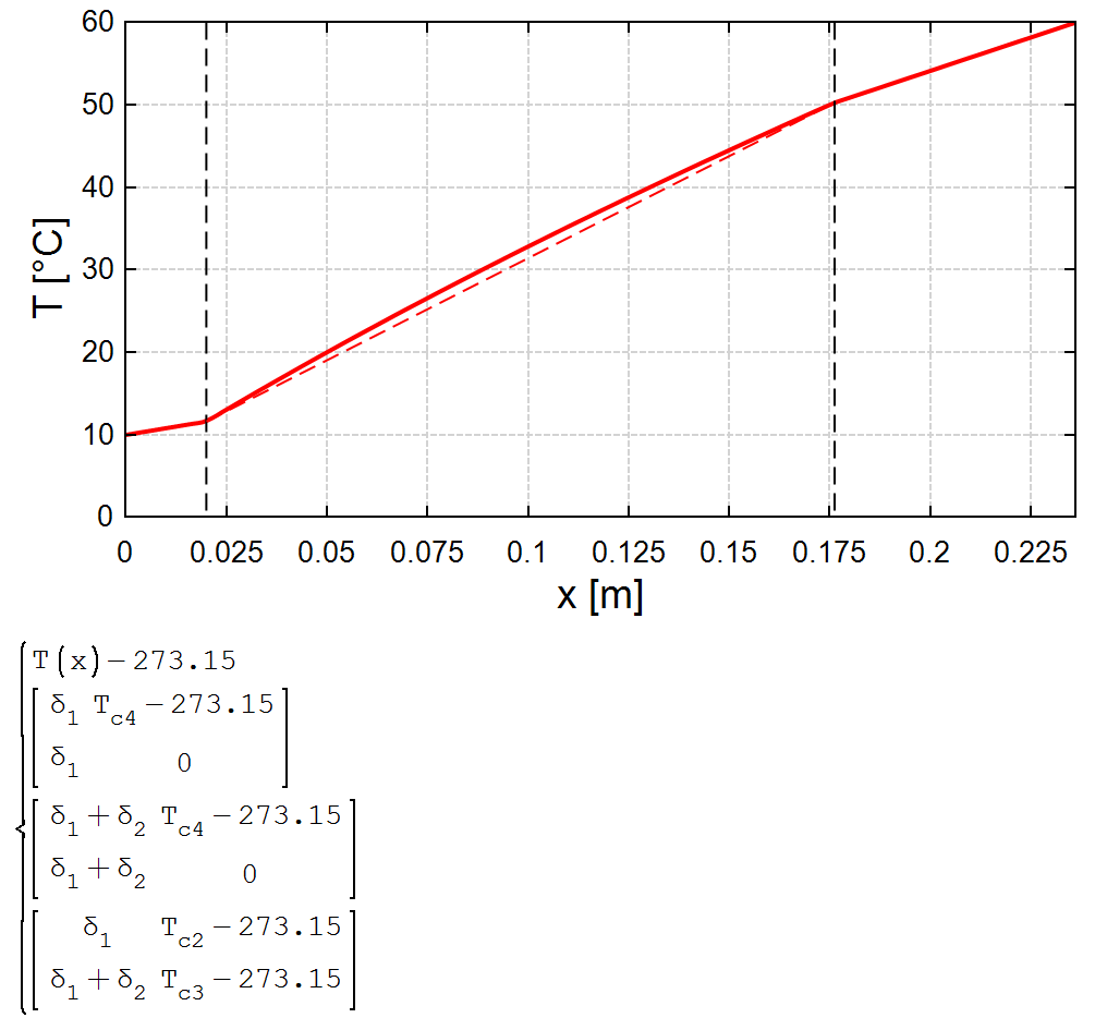

And if the dependence of thermal conductivity on temperature is more complex, obtained, for example, through interpolation of discrete data. I would like to see an integral in the solution!
![2023-07-15 12_30_20-SMath Solver - [Stenka-3-eng1.sm].png](/en-US/files/Download/SSbCad/2023-07-15-12_30_20-SMath-Solver---[Stenka-3-eng1.sm].png)
Stenka-3-eng1.sm (59.5 KiB) downloaded 1276 time(s).

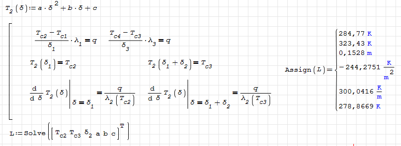

WroteI am trying to plot a temperature field in a three layer wall. There is no problem with the outer layers. But there is a problem in the middle layer - there should be a parabola, not a straight line

WroteI am trying to plot a temperature field in a three layer wall. There is no problem with the outer layers. But there is a problem in the middle layer - there should be a parabola, not a straight line. How to draw this parabola in the simplest way - with one formula. I know the hard way.
Stenka-3-eng.sm (60.64 KiB) downloaded 1258 time(s).

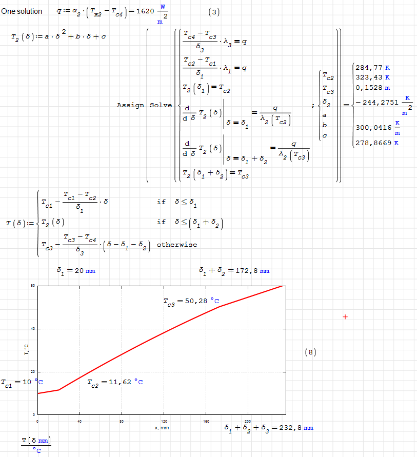

One solution from Alan Stevens
Stenka-3-Alan.sm (60.35 KiB) downloaded 1230 time(s).
![2023-07-15 12_15_54-SMath Solver - [Stenka-3-eng.sm_].png](/en-US/files/Download/AUkbkK/2023-07-15-12_15_54-SMath-Solver---[Stenka-3-eng.sm_].png)
