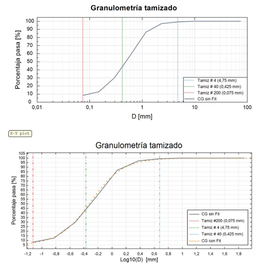

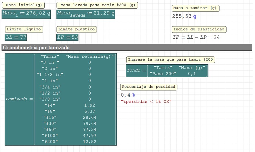

I added the logistic sigmoid function you made to the initial code and it compare with and without the fit. In addition to the initial curve, I graphed it using the Zed Graph, where it can be better appreciated using a semilogx graph
USCS-fit-Granulometry.sm (175.97 KiB) downloaded 1477 time(s).
