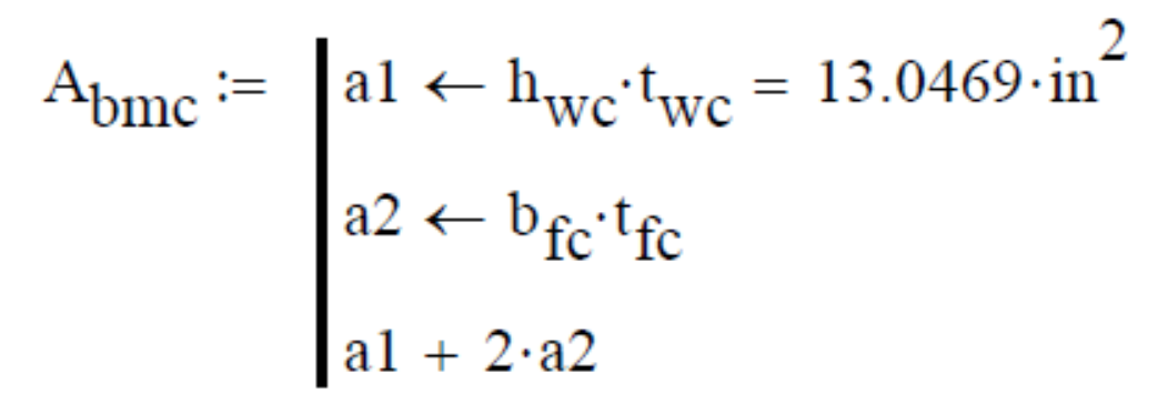

I have used Mathcad for many years, and am now trying to convert my worksheets to SMath.
I have the following that works in Mathcad: Mathcad Eqn.png

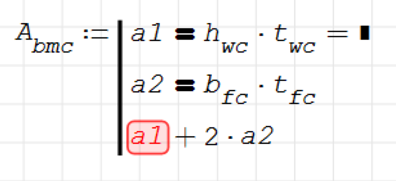

This is my attempt to recreate this command in SMath: SMath Eqn.png
Obviously, I've got something that isn't done right. I would appreciate any assistance in understanding how this is supposed to work. Thank you.

Use assignment equals:

Thank you! Works perfectly.
