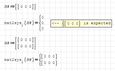

SMath Forum SMath Studio Bugs & Problems matsys.1() 1 Pages (2 items) matsys.1() - wrong conversion - Messages Go to last post #1 Posted: 12/19/2021 7:02:12 PM overlord 597 likes in 1,377 posts. Group: Moderator When parent matrix has one matrix element, conversion is wrong.More than one child matrices, no problem.Matrix converts to sys() correctly.Regards #2 Posted: 12/20/2021 8:02:47 AM Davide Carpi 1,441 likes in 2,932 posts. Group: Moderator Hello,this is related on how SMath manage the systems. To avoid it, mat2sys must be evaluated with symbolical/none optimization. If you like my plugins please consider to support the program buying a license; for personal contributions to me: paypal.me/dcprojects 1 users liked this postFridel Selitsky 12/20/2021 8:18:00 AM 1 Pages (2 items) New Posts No New Posts
