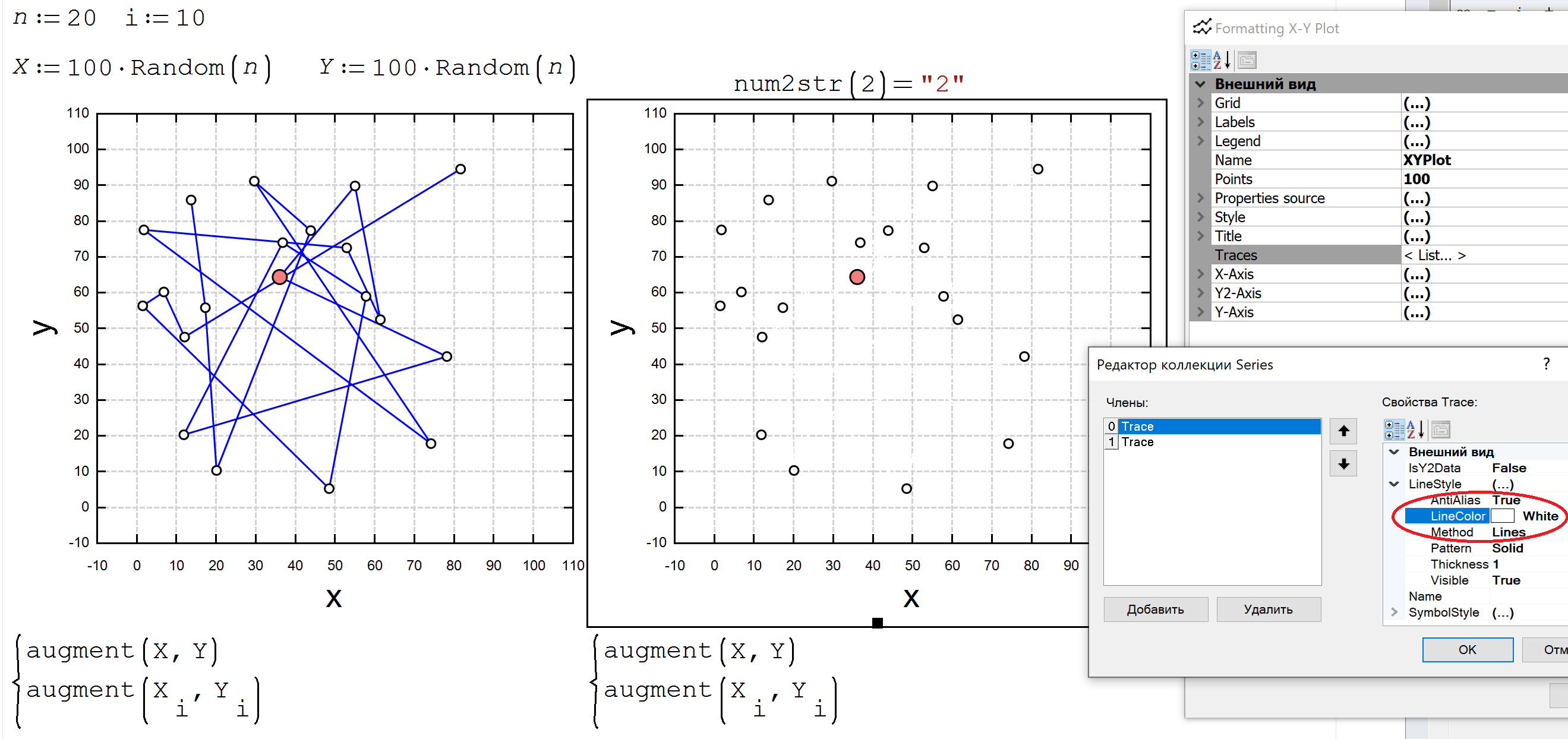

I can only remove the blue lines by making them white.
Is this my defect or the SMath defect?
Points.sm (8.34 KiB) downloaded 1239 time(s).

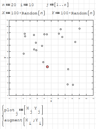

You make your plot a segment of lines by using augment(X;Y).
Make every element individual if you want them as dots.

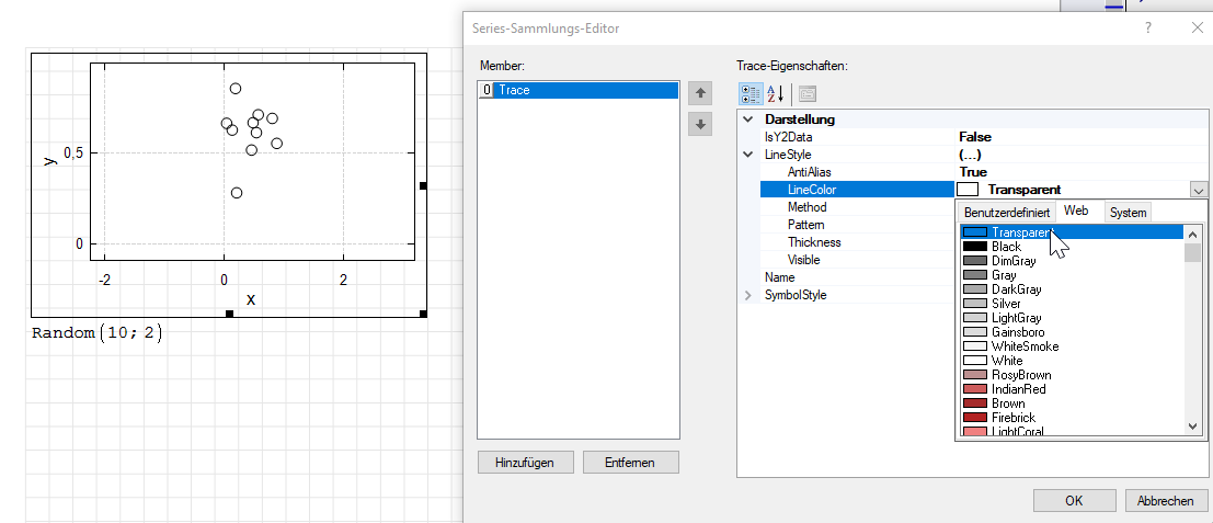

You can set the line color of any trace (input object) to transparent:
Valery Ochkov 10/25/2023 7:53:00 PM

When it is possible, I would only use 2D plot.
X-Y plot is superior, but most times not needed.
