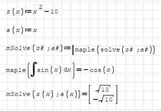

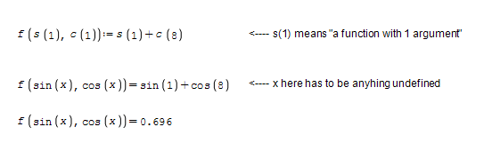

#2 Posted: 7/7/2021 8:32:56 AM
1,443 likes in 2,936 posts.
Yes it is possible, see the attached image
#3 Posted: 7/7/2021 9:31:23 AM
Paweł Wierzba
Paweł Wierzba
0 likes in 6 posts.
Thank you very much. Indeed, it works, even with functions with more arguments than one.
Sorry for asking a question about something that has already been implemented.

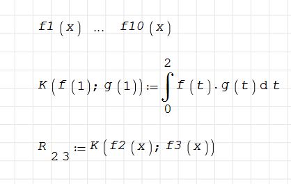

#5 Posted: 7/7/2021 10:11:06 AM
Paweł Wierzba
Paweł Wierzba
0 likes in 6 posts.
Thank you for the advice. Fortunately, standard way of defining functions is well known to me.
Unfortunately, I had to pass functions as arguments, rather than define them the "standard way".
I had several functions and some coefficients to be calculated, based on them.
Something like the example below.
If done the standard way, it would involve a LOT of writing.

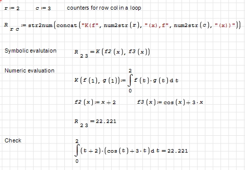

Hi. You can try a for loop with something like this in the body

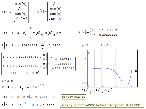

I posted the wrong image ... that's the right one.
Don't drop dead by how far simple integration can fly in the blue !

1. The previous image as *,sm
2. My Integration tool box.
Please, don't hesitate for + ... Jean

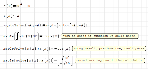

#18 Posted: 7/8/2021 4:25:50 PM
600 likes in 1,381 posts.
Looks like line() mysteriously solve the issue.
I have come across similar to this behavior before.
#19 Posted: 7/8/2021 5:21:01 PM
1,139 likes in 1,805 posts.
Hi. For help understanding what's happen: that behavior is similar to the SetDelayed in Wolfram Mathematica language: https://www.wolfram.com/language/elementary-introduction/2nd-ed/39-immediate-and-delayed-values.html
