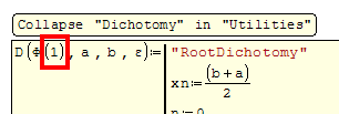

#3 Posted: 11/25/2016 7:51:16 PM
Wrotedoes not evaluate
You have to change the argument Φ into Φ(1) in both the algorithms (RootSecant and Dichotomy)
![2016-11-25 23_47_10-SMath Studio - [Solve%20roots_solve%20RootSecant.sm_].png](/en-US/files/Download/6ZSv87/2016-11-25-23_47_10-SMath-Studio---[Solve%20roots_solve%20RootSecant.sm_].png)
Not sure why it magically works in 5346, however in this way has the same behavior in both the versions.

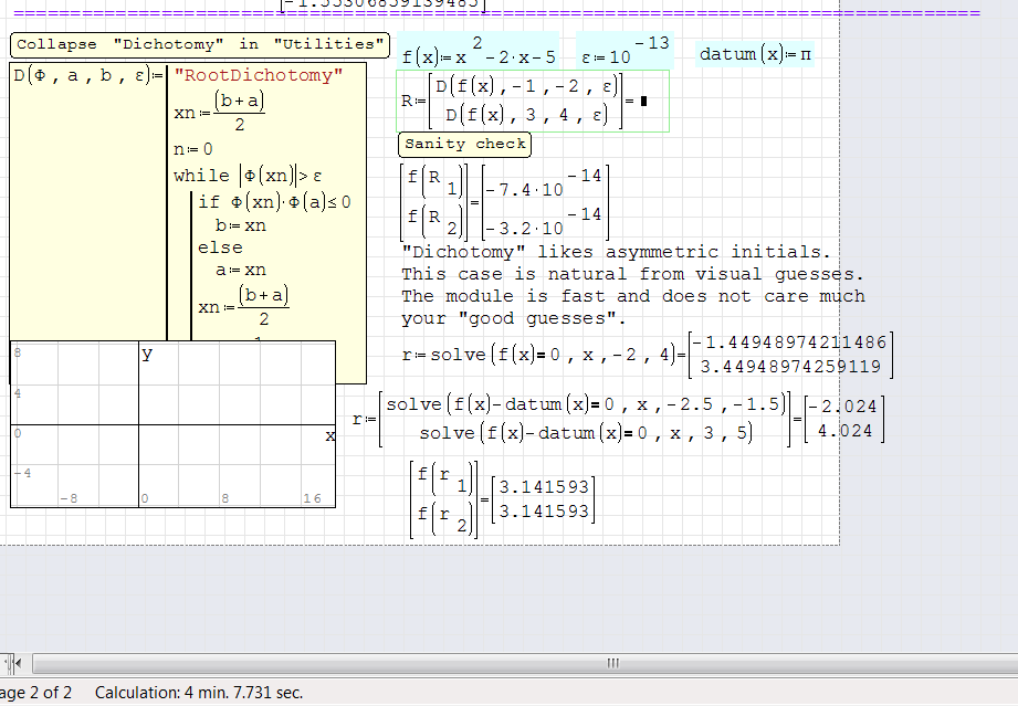

In the original algorithm, functions is not passed by the argument (both in 5346 and the latest), because first argument is not declared to be a function (to figure it, you can replace first argument in RootSecant/Dichotomy definition with a non existing variable, like zzz, you will see the worksheet still works in the same way). The link with the functions in the worksheet is given by this definition, just below RootSecant:
![2016-11-26 00_39_01-SMath Studio Desktop - [Solve%20roots_solve%20RootSecant.sm_].png](/en-US/files/Download/GSCbK6/2016-11-26-00_39_01-SMath-Studio-Desktop---[Solve%20roots_solve%20RootSecant.sm_].png)
Here is the cause of the different behaviors:
- In SS 0.97, f(x) is kept as symbolical definition even if f(x) already exists, hence when you call the algorithms the function Φ(x) to solve in the algorithms is the last f(x) defined before the use.
![2016-11-26 00_41_12-SMath Studio Desktop - [Solve%20roots_solve%20RootSecant.sm_].png](/en-US/files/Download/C6Roso/2016-11-26-00_41_12-SMath-Studio-Desktop---[Solve%20roots_solve%20RootSecant.sm_].png)
- In SS 0.98, the definition stores the content of f(x), hence then you ask the algorithms to solve always the same function, bracketed in different locations (wrong bracket -> infinite loop).
![2016-11-26 00_48_02-SMath Studio - [Solve%20roots_solve%20RootSecant.sm_].png](/en-US/files/Download/7pCNDM/2016-11-26-00_48_02-SMath-Studio---[Solve%20roots_solve%20RootSecant.sm_].png)
