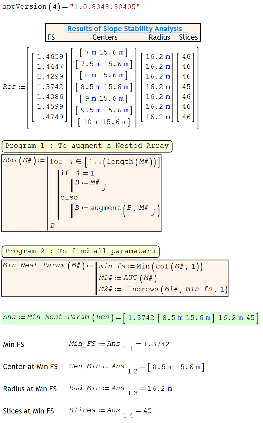

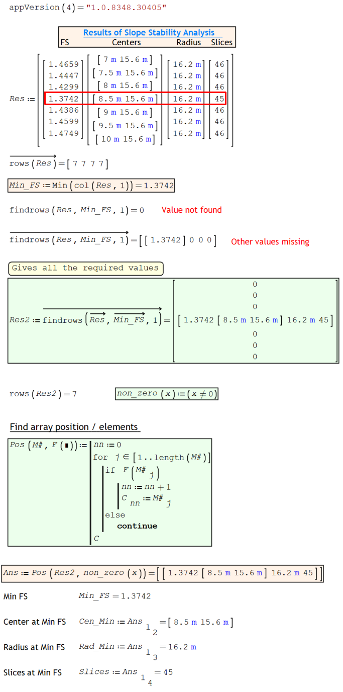

I came across a problem in the use of findrows() function when applied to a nested array.
The nested array is the result of a Slope Stability Analysis example.
Sufficient explanatory notes included.
However, I was able to get required values by some manipulations as shown.
Is there a better method ?
Findrows Problem.sm (19.99 KiB) downloaded 1204 time(s).

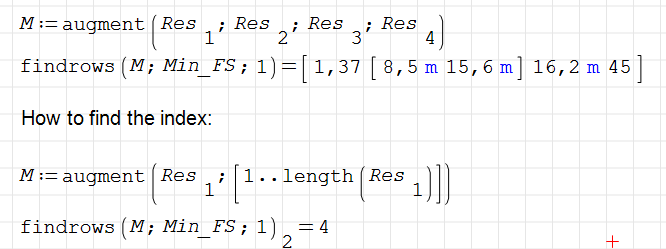

#3 Posted: 9/10/2023 3:24:29 PM
I'd perhaps just join the columns by augment() and then apply findrows().
Findrows Problem_Kr.sm (23.92 KiB) downloaded 1162 time(s).
![2023-09-10 20_19_16-SMath Solver - [Findrows Problem.sm_].png](/en-US/files/Download/PkMKH3/2023-09-10-20_19_16-SMath-Solver---[Findrows-Problem.sm_].png)
