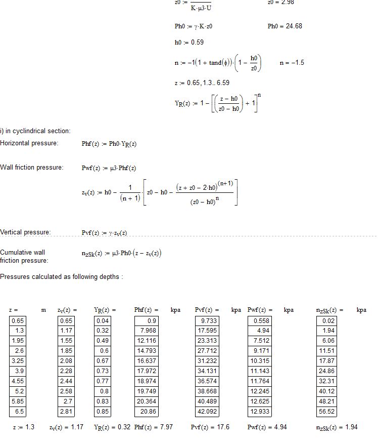

There is no more red in the attached.
Corrections in yellow.
There was/there is shadow in the project context
en 1991-4 jmG.sm (688,51 КиБ) скачан 1285 раз(а).

Thank you Jean for your considerations.

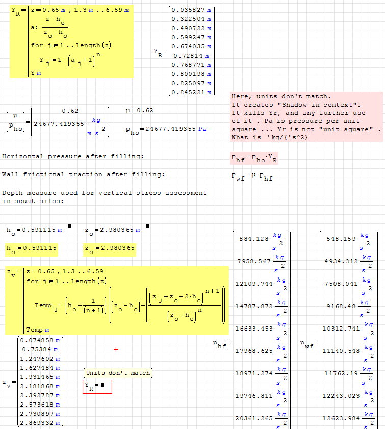

#28 Опубликовано: 31.08.2016 21:27:02
You don't confirm if it has doctored your Smath version !

#30 Опубликовано: 31.08.2016 23:49:19
#31 Опубликовано: 01.09.2016 00:08:01
'kg/{'m*'s^2} What is that in Smath ?
N = kg * m/s2

Berk,
please don't consider the posts about units mismatch. There is misunderstanding WRT units in general, and their handling in SMath.
'kg/{'m*'s^2}='Pa. That is algebraic decomposition of SI complex unit, and as the decomposition is purely mathematical, it doesn't necessarily has physical meaning.
Also, Pa is not pressure per unit square. Pa is a unit of pressure, and pressure itself is force per unit square, or energy per unit volume. Note that the same unit (and the same physical property: pressure) may be decomposed differently and ccorrectly even from physical PoV. The two decompositions (per area / per volume) are very useful in different applications: first one in construction to represent forces, second one in hydraulics to represent energy.
So, the decomposition you see in SMath is mathematical one to most simple SI units, and it is done inside the app without taking into accocunt physical meaning. But it is mathematically correct, and so compatible with correct usage of units.
С уважением, Михаил Каганский

Hello mikekaganski,
I have managed out to create it with (z) function. You could see it attached. But how can I eliminate vectorize function to be added this formulas? Some of them is not working if I don't use vectorize.
en 1991-4 (z).sm (603,38 КиБ) скачан 1249 раз(а).

I am creating this file from scratch and it is the first time I am using SMath. So I have to complete all the equations and variables and definitions. Then I will decorate the sheet with what it needs (silo sketch, codes used, header and footer (actually I need help for print settings), etc.). It is a time consuming process as I used mathcad for this type of calculations before. If you have sample calculation report for a steel silo or another structure created by SMath, it would be very helpful for me.
For the other replies from you: I started to use the variables with their unit. When I get the result by entering variable "z" SMath is creating a unit by itself. Then I change it manually because I know what it should be. The beauty is that, if I enter wrong unit for the result, SMath adds a unit to make it correct, then I can understand if there was a mistake. This feature is great.
You have created new variables "a" for z-ho/zo-ho but it should't be needed to calculate I guess. I attached the mathcad version of that part here and as you can see there is no separation needed for the formulas. In addition it is working even the "z" has been determined before the formulas created.
