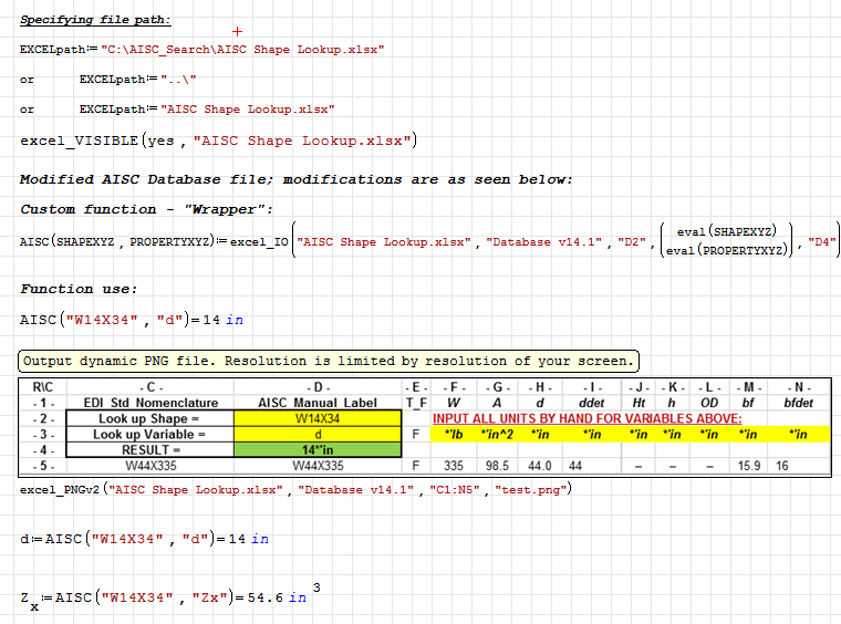

Alexander O. Melnik
Alexander O. Melnik
Not sure if I am grasping the root of the issue, but you can fairly easily write a wrapper as a smath user defined function using excel_IO. One would think that this way you can write a wrapper for any custom .dll for EXCEL.
All I have done was creating a simple Index(Array,Match(),Match()) lookup in EXCEL (with proper implementation of SMath units), and used excel_IO to work with it.
Seems to work very fast.
As always - please test for bugs and use at your own risk.
P.S.: Update excel plugin for proper handling of cell error values
AISC Shape Lookup.xlsx (3,27 МиБ) скачан 1932 раз(а).
Steel Properties Look-up.sm (20,36 КиБ) скачан 1441 раз(а).

My goal is be able to define a larger number of variables as quickly as possible. Lets assume that I need to define all the section property variables inside SMath in order my calculation to work properly. I like to establish these properties inside a function for two reasons - 1) it helps prevent variable definition overwriting. 2) I can call it many times through-out the page.
Ultimately I would set up an Smath page with multiple beam designs on the page.
Here is the condensed version of my issue:
Steel - Property Lookup Test.sm (29,71 КиБ) скачан 1303 раз(а).
AISC Shape Lookup.xlsx (2,91 МиБ) скачан 989 раз(а).
Here is what I'm working towards:
Steel - Function - WF Design.sm (84,79 КиБ) скачан 1365 раз(а).

the database and spreadsheet get regularly updated. this file in fact has been in use for 15+ years. when updates to shapes occur, these files get republished. that way, there is some predictability in accuracy in information, and repeatably.
ryan- look again at the example that Alex.M put up. I think I emailed you another example sheet when i got it figured out. all you do is program the shape and property you are looking for and it talks to excel and it spits it back to you. you don't have to worry about lookups and column numbers.
it pains me to say so, but i think that you are doing way more work than is needed in your example calc. and there is the issue of verification. by burying the calcs in hidden sections and then recalling it is hard to check and verify. are you really saving much time doing this sort of calc in SMath vs something like RAM Sbeam? for one beam design, its hard to beat.
here are some examples of how the calcs are done in excel. first picture has 2 halves. left half is what i print. right half if i need to put it in the calcs as a reminder or for review/permit. individual cells in gray on the left are user input.
the second picture, the stuff in gray is what is behind the image of the connection on the right side, and is some of the work in the background. and yes, i am little guilty of doing the same thing i pointed out to ryan as bad form, but the calc topic and result is more explicit.
I think the best solution right now is what Alex provided us so far- giving us a pseudo-wrapper to push/pull from excel. we can simply define the shape and the property we need and move on with our calcs.
I am working on some handrail calcs right now that I am updating to the new way and will post some examples soon.
Dennis

While I am uncertain what would the the best approach to this problem, I am dedicated to make my excel plugin work as intended.
To RFreund and SinneD:
It seems that when my plugin is called inside a programmed function it has a difficult time identifying the working directory on its own. See a work around attached (define absolute path by concatting workingdir() and xlsx filename). I might try to pinpoint the bug if I have time - use the work around for the time being.
To ioan92:
I would much appreciate if you could let me know why the plugin does not work for you - again I am dedicated to fixing it if necessary. A good starting point is to delete and redownload the plugin from extension manager - it is still work in progress.

First of all I would not want to take credit for something I have not done - it was RFeund who created the majority of the SMath workbook you were looking at. I just helped him to make it work as he intended. So I will leave it up to him to incorporate first of your two very relevant comments.
Small note though - the latest version of the plugin (0.2.0.28218) should import values with units from excel. Those units can be converted to inches as per usual SMath operation:
I will want to learn how to use combobox plugin - I beleive the worksheet you attached earlier is a good guide :-)
Thanks,
Alex M.

The reason why excel_IO plugin connects to an already open file is because it works with EXCEL api and can connect to running instance of EXCEL. It does not quit the EXCEL process; instead it connects to it, makes it invisible, and does the calcs. Once SMath workbook is closed the plugin will make the EXCEL window visible again.
I believe Davide's plugin reads/writes xlsx files directly (unless the file is locked by EXCEL or any other process) - this is very useful for folks who either do not have EXCEL installed, or do not want SMath to rely on any dependecies (both are very valid reasons / desires).
Davide Carpi 06.01.2016 19:14:00, ioan92 06.01.2016 13:52:00

Excel- excel seems to remain open, hidden or not. Alex described it exactly above. I often already have Excel open calculating other things already that I use to manually input into SMAth worksheet. I noticed that if SMath takes the focus from Excel doing work called up by SMath, then the other open spreadsheets get flaky really quick.
I have taken to:
-explicitly defined the directory and file that within SMath
-force Excel to be visible.
This is what I have been putting in my worksheet to be explicit for definitions. I am still trying to work through Davide's example.
Davide Carpi 06.01.2016 19:21:00, ioan92 07.01.2016 08:12:00
