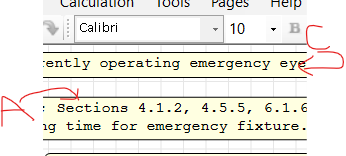

I'm assuming that the document mode is accessed via the button on the lower right next to the zoom spyglass. When I hover over it, Windows 10 as I never got the fonts fixed in Linux, it blinks like crazy and it's hard to select.
In addition, I ran into an issue trying to upsave some old files. I updated the font to Calibri and now the text in the descriptions do not match. New variables are using calibri and old variables that I carried over are still in Ariel
Thank you. Fixed now in the latest nightly build.
It was decided to show all descriptions using monospace font with no regards to what font is set as default for the document. This was implemented few Months ago.

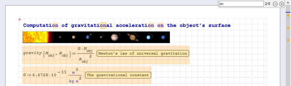

Important improvements in todays update: https://en.smath.com/forum/yaf_postst20114_Beta--SMath-Studio-0-99-7691--21-January-2021.aspx
Search in text significantly improved:

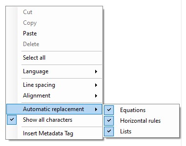

Invisible symbols can be shown:
Automatic replacement can be disabled:

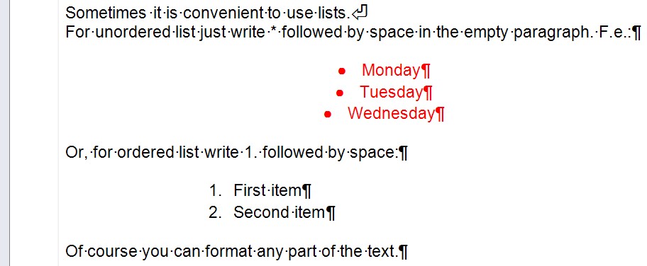

+ work with ordered/unordered lists significantly improved.
