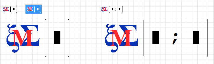

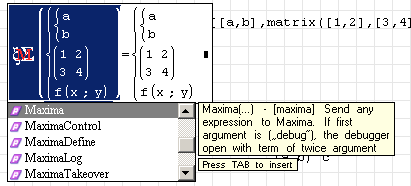

PLUGIN UPDATED
- SS-83: custom skins for Maxima wrappers
The skin is applied to any Maxima(#) function (regardless the number of arguments)
As mentioned in the BTS, if is in Kay's plans (and there aren't bugs/things to change) he can copy the IPluginRegionDrawing code inside the Maxima MainClass.cs to have this feature embedded in the plugin.
Best regards,
Davide
sergio 03.03.2016 15:32:00, Martin Kraska 27.05.2014 15:19:00, Radovan Omorjan 27.05.2014 15:18:00

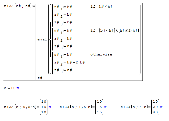

I have a problem with the function 'cases' if used within the definition of a function that expects as a result numbers or strings.
[albumimg]353[/albumimg]

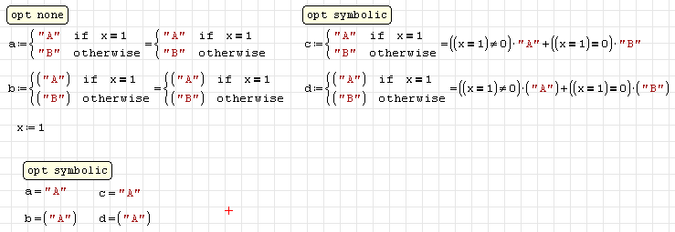

cases() can only handle results that can be multiplied, as the function is expanded into a sum of the possible results multiplied by individual boolean statements, resulting in 0 or 1. Unless Andrey allows multiplication of strings (which could be very useful, at least multiplication by integers) or unless Davide changes the implementation of cases(), you are limited to numbers, matrices, lists and the like.
You can, however, wrap your strings into matrices and extract the element afterwards. That is not really a good solution, because outsiders won't comprehend the role of the index. Last not least this is also due to that one cannot tell the matrix brackets from ordinary algebraic ones
Edit: The above said applies only to numeric evaluation of the result. The solution is much easier, just switch the result optimization to "symbolic". This works no matter how the optimization setting of the definition is made.

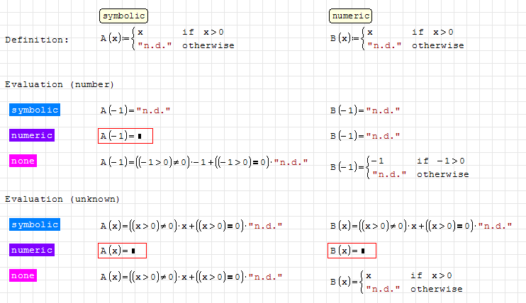

Ciao Sergio
switch the optimization of the [math eng]s.c(z)[/math] definition to "numeric" or "none". This uses a nested if/else structure instead of the symbolic sum (available just if you define your function as "symbolic"; this is shown also in the first post attachment).
In wide worksheets you can check fastly the definition optimization calling an evaluation using "none" as optimization:
- if you see the sum with booleans, you have defined the function as symbolic;
- if you see the cases function, you have defined the function as numeric/none.
best regards,
Davide
sergio 06.06.2014 16:14:00

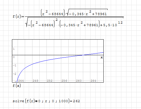

#30 Опубликовано: 16.05.2015 04:53:29
madan26
madan26
exec1
exec2
I have solved this equation in sage math. Please guide me how to solve this equation in smath.
#31 Опубликовано: 16.05.2015 05:57:00
You can try using solve
Here an example based on your function (stripped off some decimals, just to make the example)
P.S. if your question is not related with a plugin in particular, the next time please open the question in a new thread in the Questions section

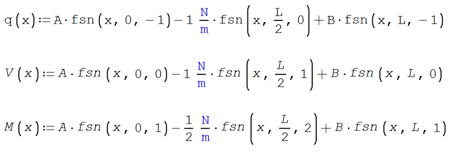

Oscar Campo
Oscar Campo
I'd propose two custom glyphs:
The Macaulay bracket and the Mathcad column operator. The column operator has been requested elsewhere, I just put it here in the right thread...
I use this function :
Is useful to model beams on this way:
Please, see the attached file
QVM.sm (23,19 КиБ) скачан 1073 раз(а).
ioan92 24.08.2025 07:56:27
