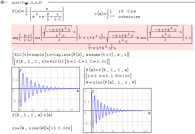

Hi, this is a snippet for numerical inverse Laplace transform. You can find time response of a system expressed in F(s) form.

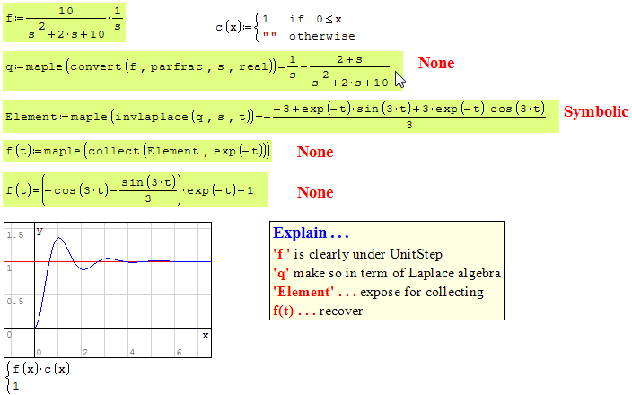

That one was well covered, two last remarks:
1. That Smath does not trig example [1], rather in terms of exp(,)
OK, unfamiliar ... but much faster as it involves only one numerical approximation.
Whatever: it's the Maple business, from which Smath depends upon.
2. last visit [red/cyan[ is sometimes of importance as demonstrated.
InvLaplace2 Otherwise.sm (49.53 KiB) downloaded 1378 time(s).
#42 Posted: 9/24/2018 10:21:12 AM
... when you deal with Laplace stuff, open your school book,
that will help setup Laplace Algebra appropriately, like this:

Hi. Improved version, works faster. Coefficients for the inversion are precalculated outside the inverter caller and avoiding vectorization for more compatibility of the inverter.
InvLaplace3.sm (98.32 KiB) downloaded 1433 time(s).
