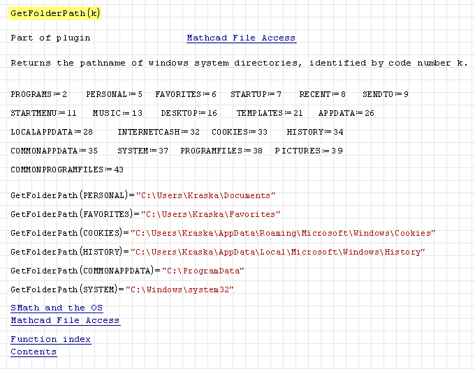

#36 Posted: 10/29/2019 5:05:48 AM
The function getfolderpath() seems to be broken for build 7219:
getfolder.sm (2.21 KiB) downloaded 1611 time(s).
![2019-10-29 07_52_04-SMath Studio 0.99.7219 - [Blatt5_].png](/en-US/files/Download/spgdML/2019-10-29-07_52_04-SMath-Studio-0.99.7219---[Blatt5_].png)

Вячеслав Мезенцев 10/31/2019 2:04:00 PM
#37 Posted: 10/31/2019 2:05:49 PM
Updated and rebuilded for SMath Studio ≥ 0.99.7109.
