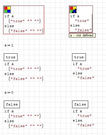

#31 Posted: 9/26/2014 3:26:38 AM
1,443 likes in 2,936 posts.
Hello brotjob,
I cannot reproduce (or I've misinterpreted the issue)
I see what is shown in the screenshot
