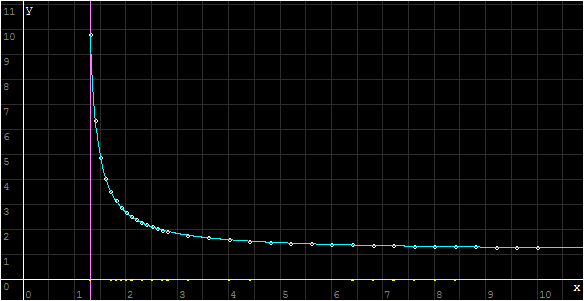

Hola Carlos. This is another approach.
PileRedux_Factor_CBG.sm (115.19 KiB) downloaded 1295 time(s).
PileRedux_Factor_CBG.pdf (376.79 KiB) downloaded 710 time(s).

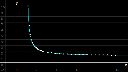

#22 Posted: 3/28/2019 10:00:16 AM
This is an approach, maybe Jean or Alvaro, can Doctor it
Hello Carlos, maybe like this ... solve(2) to let the solver breath freely.
PileRedux_Factor_CBG [1].sm (24.35 KiB) downloaded 1104 time(s).

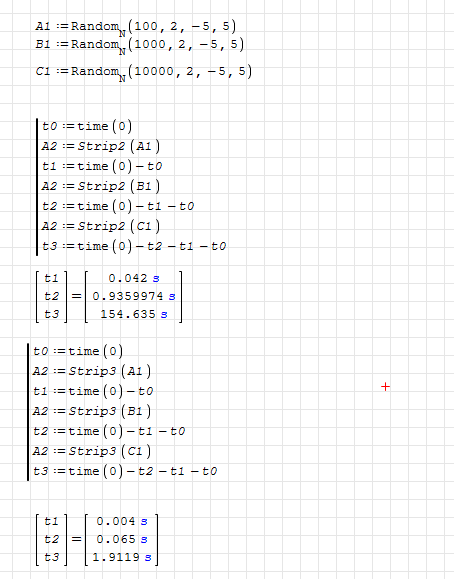

#23 Posted: 3/28/2019 10:56:11 AM
Arie
Arie
94 likes in 285 posts.
Hi Jean,
See attached. I've modified your strip2() algorithm [See Strip3()]. On my PC it performs same calculations ~10x faster. Might help with large data sets.
PileRedux_Factor_CBG [1]_alyles.sm (31.33 KiB) downloaded 1151 time(s).
#24 Posted: 3/28/2019 12:37:37 PM
Arie
Arie
Here's some proof of that.
#25 Posted: 3/28/2019 1:24:24 PM
Hi Jean,
Thanks alyles ... Good job !
#26 Posted: 3/28/2019 1:37:05 PM
CBG
CBG
78 likes in 312 posts.
Hola Alvaro.
Gracias
I make the next comment. In none of the 3 graphs that you show,
the scale of the "Y" axis, reaches the value 10, so I think,
it would be necessary to expand the scale to verify that the curves are correct
Carlos
#27 Posted: 3/28/2019 1:41:53 PM
CBG
CBG
Hello Jean
Thank you so much .
Very pretty
Carlos

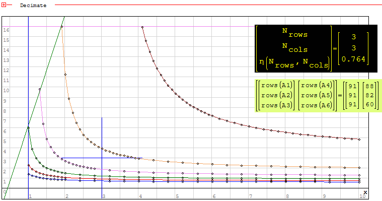

#29 Posted: 3/28/2019 10:29:22 PM
Hello Jean
Thank you so much. Very pretty. Best Regards. Carlos
Hola Carlos,
Few more things to improve presentation ...
Decimate part of the A1, A2,A3 . Confirm project is valid
particularly withe 'z' target in A solvers.
Project PileRedux_Factor_CBG [1].sm (30.8 KiB) downloaded 1136 time(s).

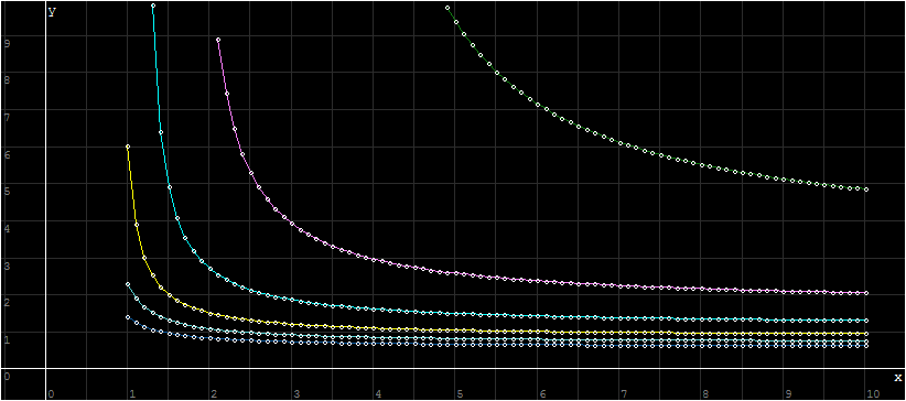

#30 Posted: 3/28/2019 10:42:38 PM
1,123 likes in 1,795 posts.
... I make the next comment. In none of the 3 graphs that you show,
Hola Carlos. Maxima shows 10 for both axis, IPlotSolve, by construction, only can take two vectors (x or y and lambda) but not 3 (x and y and lambda).
For pIPlot and pVField, just change the Box in 'B'. I take columns only one to five.
#31 Posted: 3/29/2019 9:45:43 AM
Hola Carlos,
... decimated plots are lot more presentable.
At this point, for a specific target solution
easy to get a Thiele analytical formulation.
In the mean time, I will test some decay model.
Project PileRedux_Factor_CBG [1].sm (46.98 KiB) downloaded 1097 time(s).
#32 Posted: 3/29/2019 12:42:43 PM
... a pretty good fit. More models to be explored.
Project PileRedux_Factor_CBG [1] Rational Fit.sm (58.08 KiB) downloaded 1136 time(s).
#33 Posted: 3/29/2019 5:40:28 PM
... patience is rewarded, an exact fit
considering the inexact solver solutions.
Project PileRedux_Factor_CBG [1] Exact Homographic.sm (50.54 KiB) downloaded 1118 time(s).
